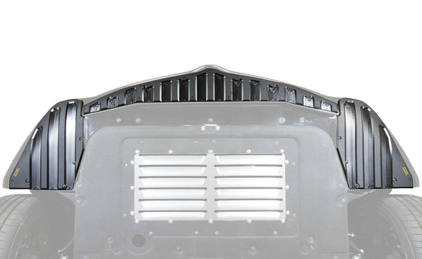

5. What would be your recommendation regarding protecting the nose from scrapes. I’ve seen several approaches to this in the forum but can’t tell which is best.

5) I use nothing except being careful. Anything you add makes the nose effectively lower and more likely to scrape.

4. Nose scrapes? can’t really help. I left it too late. When the nose gets a paint next year I’m going to use some adhesive rubber strips I’ve used for my Giulietta….Can’t think of the product name at present (Edit: SLIPLO. Thanks, Matthew.). The vinyl I initially used wore through.

SLiPLO works for me. A cheaper and better option if you don’t want to screw your bumper.
Thanks for jogging my memory, Matthew. That’s what I’ve used for my Giulietta. Some will go on the nose of Rosie next year once she gets a touch-up (so to speak).
