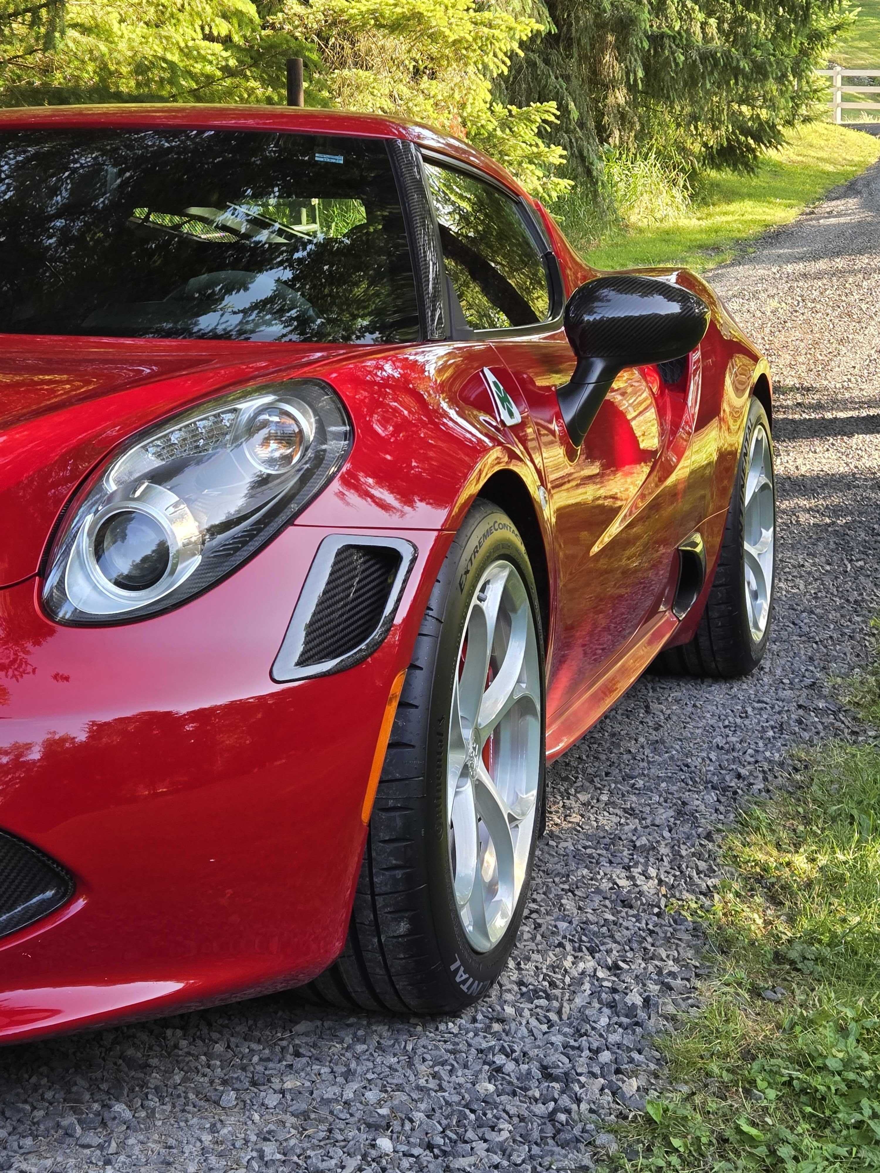

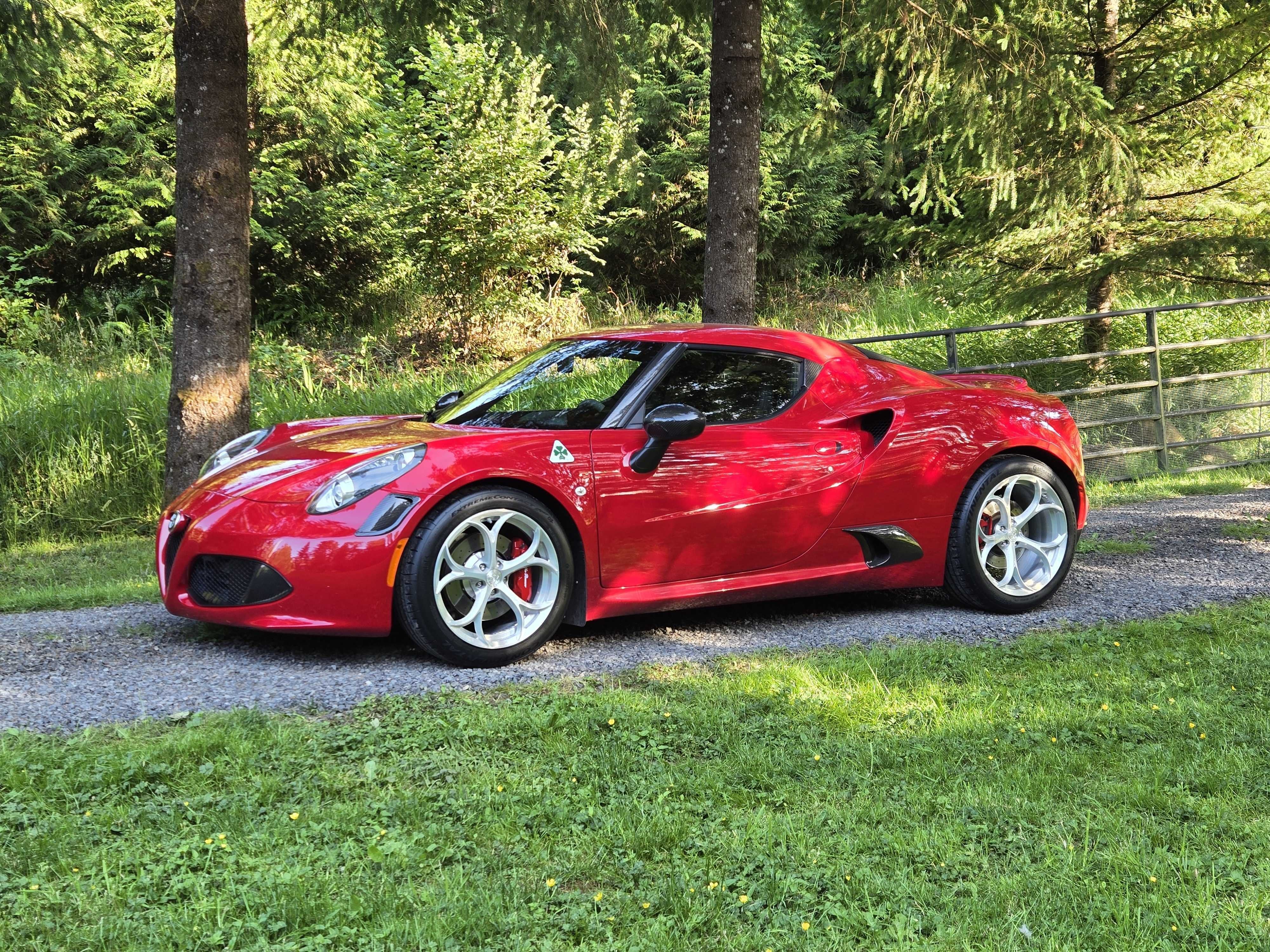

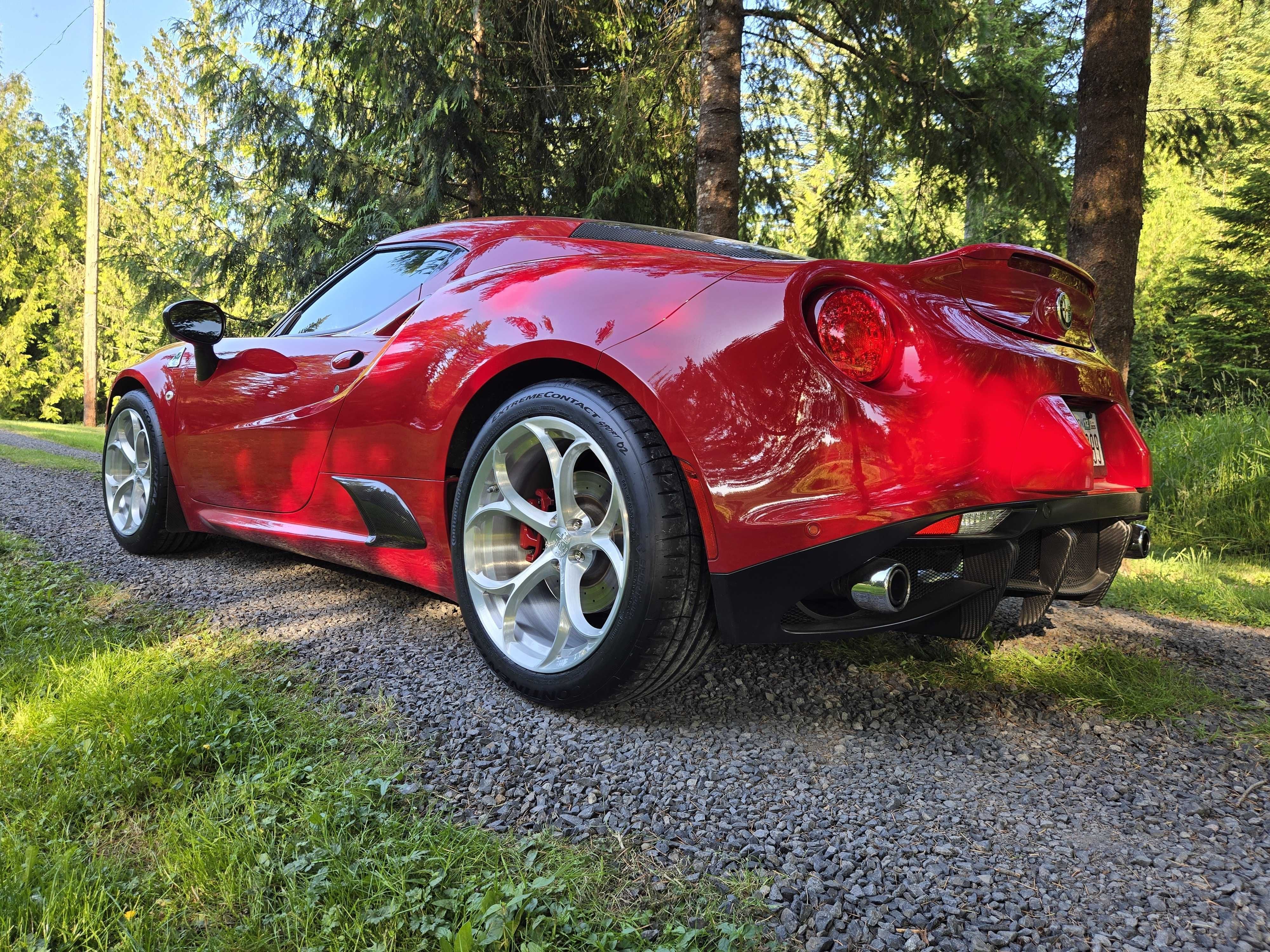

Hey Crew, it was worth the wait!
I received my 17x8" ET 32 / 18x9" ET 31 Gabriellas in brushed aluminum gloss. I love them! I feel like they give the 4C an '80s/'90s Ferrari feel with the Red/Black with silver.
I'm running Continental 255/40R18 99Y / 225/45R17 91W CONTI EXTREME CONTACT SPORT 02 BW
BTW,
Factory 18"/19" wheels with mounted Michelin PS4 A/S weighed:
215/40R18 - 41.8 lbs
235/35 R19 - 45.4 Ibs
The 17/18" BSPK Gabriellas with the mounted Conti Sport 02s weighed:
225/45R17 - 38.8 lbs (wheel 13.8 lbs!)
255/40R18 - 43.8 lbs (wheel 18 lbs!)
I got wider wheels and saved the 9.2 lbs, so I'm delighted. I also love the way the Contis feel; I appreciate the extra sidewall, and the grip is there. They also aren't picking up my gravel driveway, which is much appreciated.
@John4C, the only thing I would have preferred is a bit less offset for the fronts. They are hella flush and look great, but I worry about my paint. The rears are perfect!
