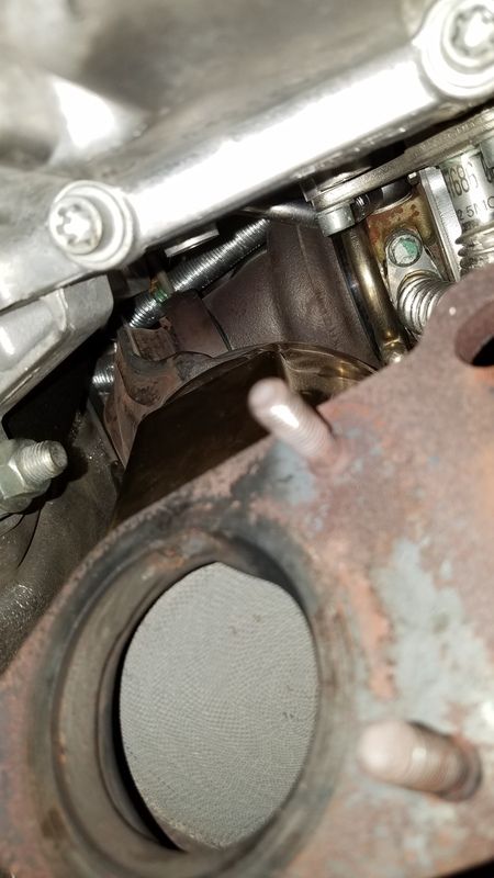

Anyone have tips for removing the downpipe v-band clamp? Everything down wind of the turbo has plenty of room to work with, I just can't get to the v-band clamp. Maybe I'm missing something..

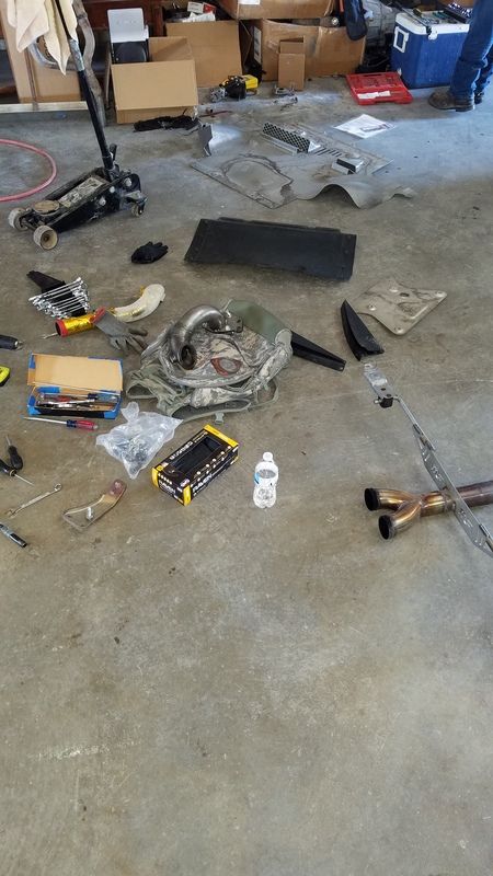

I just did mine today. Indeed that is the hardest part. We removed the exhaust manifold intake & Air intake from the top side which gave access to the black shroud that is sorta in the way. For whatever reason, the V-band bolt and nut are on the top side. Putting the catless downpipe in is cake and there is much more room to work with. Re-install the V-band at the bottom for easy access to the bolt. 10mm I believe.
Took us 4.5 hours with a quick lunch break + had to run to home depot because my buddy snapped the V-band bolt w/ his impact lol!
Sorta crappy because it only took us about 40min to get underneath, remove the lower intercooler hose, midpipe, and tail pipe. The engine was too hot surprisingly. The downpipe / turbo were fine to touch. The remainder of the time was indeed trying to figure out where the hell the v-band bolt was and accessing it!

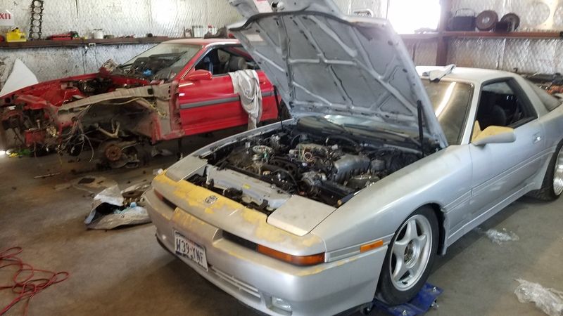

Easter egg. Buddy blew up his red supra. hit 50lbs of boost and blew oil all over the wheel and tossed him in a ditch lol. Obviously did not intend for it to go past 26 I believe. FOrget what happened.

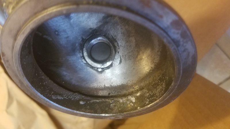

Downpipe install:
Wasn't too happy with the quality from Novitec. Had carbon build up all around and look like it was used? Whatever tho, I just had to scrub w/ a brush.
Oddly enough, that black cooling shroud is the only thing holding me back right now. There is a hardline (guessing AC?) that is routed in a manner that covers the top of the cooling shroud preventing me from pulling it off.
Once that's out of the way, I don't see the rest of this job taking more than an hour including reassembly.
Yeah its home stretch from there! I don't recall anything in the way of the shroud. Just the 2 air intake hoses I thought? Pics?
