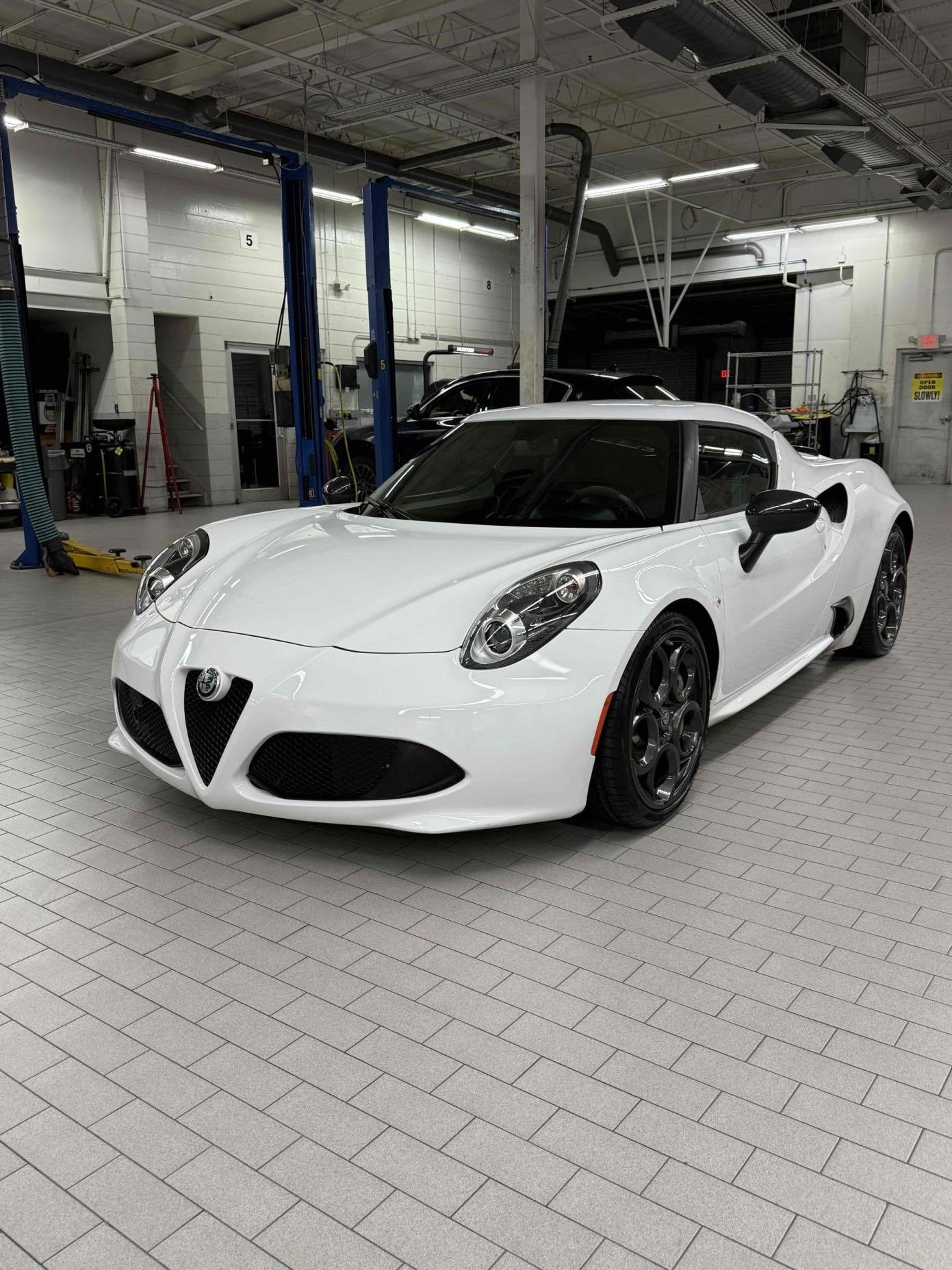

Just purchased a 2017 4C with 4.3k miles on it. Already put 1k miles on it…love it.
It’s completely stock and I have a track day set up in a few months. My first time on a Track (I will have a co-pilot).
do I need to upgrade tires and all the jazz (they have the stock tires but the previous owner purchased a new set a year ago so they are new). I’m not going to push it much in the track but excited to let it stretch its legs a bit.
I might take it a few times a year on a track so not sure if upgrading it when I am not really going to push it.
it’s an amazing car. I saw it on Top Gear 10 years ago and knew right then and there if I ever bought a two seater this would be the car.
glad I pulled the trigger now!
