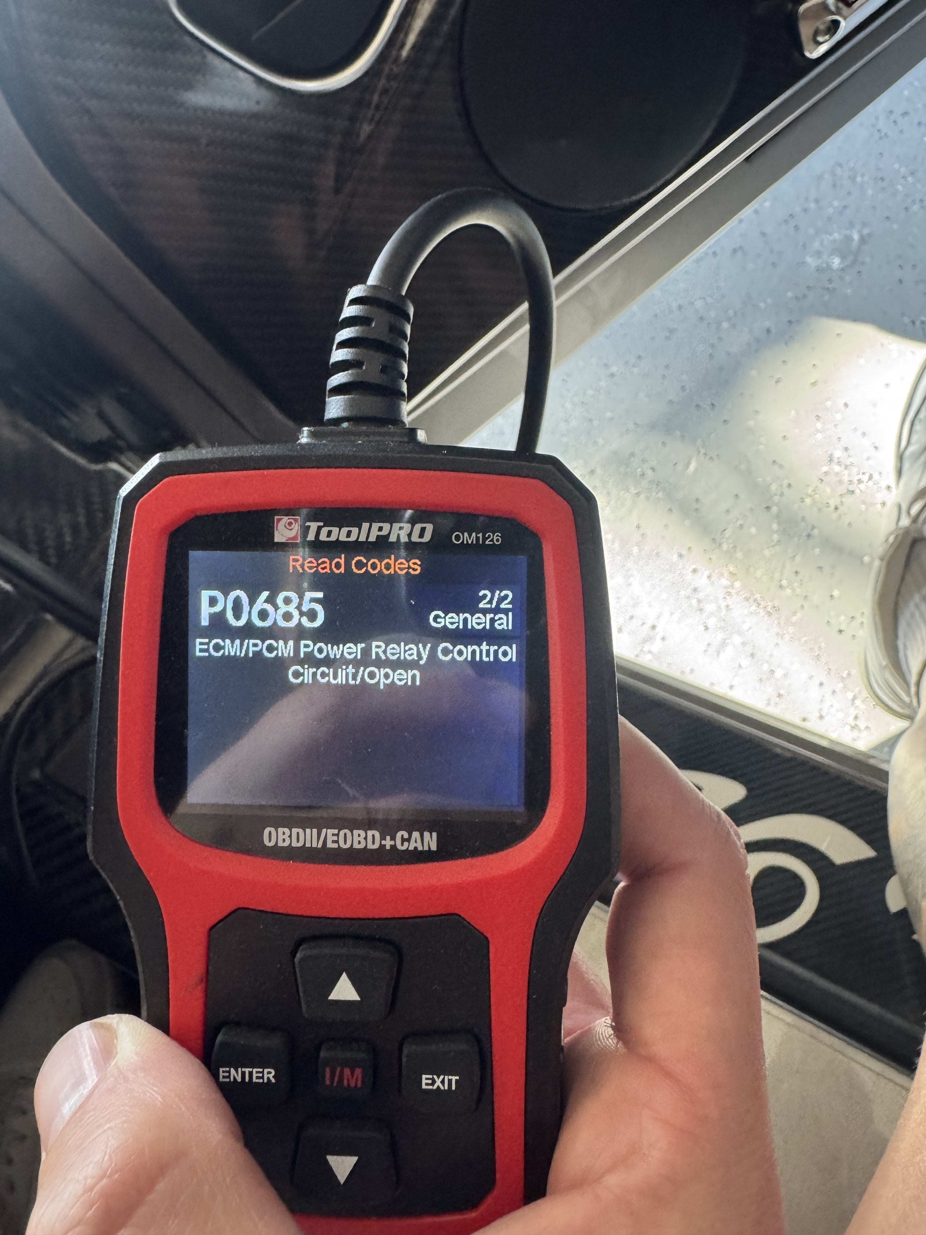

Tried to go to the Alfa show with the 4c only to find it won’t start.. it’s been on trickle for weeks so not thinking battery
I’ve got this error, any tips is it maybe battery
I’ve got this error, any tips is it maybe battery View attachment 172323
still ?
Your gear change actuator looks like it’s stuck either open or closed.
Interesting any tips here haha
Do you get the priming pump noise when you open the drivers door?

Got all the sounds and lights yeh unusual drops to 10v on turnover
removed battery took to shop he said dead around 11v couldn’t test it, have got a new battery $270 and bam she starts fine
Now you know why the actuator arm was stuck…😁 Not enough voltage to knock it into neutral.
