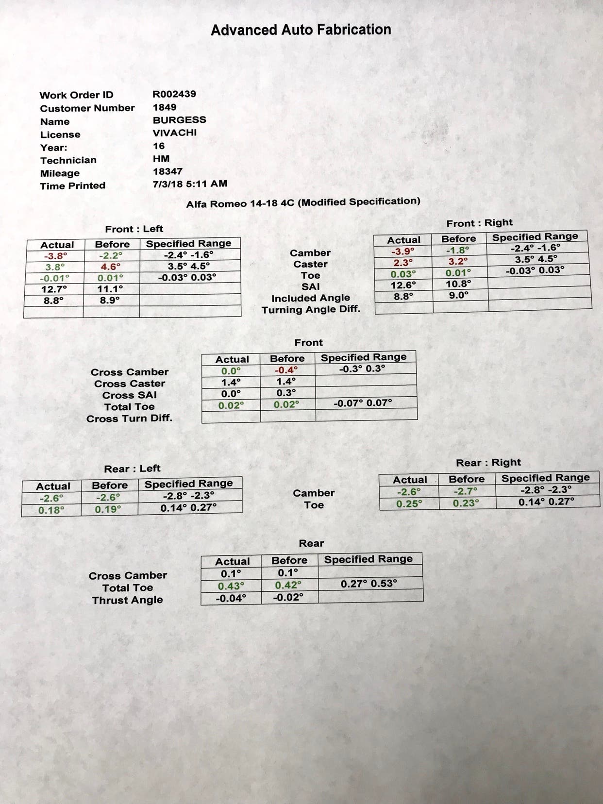

I’m putting this in Motorsports because these settings are ideal for track use only.
I was only running about -2 degrees camber in front before and it was great but I was wearing the outside of my tires a little bit more than rest and I knew I could get some more but I never thought I would get this much!
Today I took my car to my local race shop and told them to dig into it and grind shims, remove shims and do whatever they could and see what they come up with to get me the most negative camber possible.
Result is -3.8 and -3.9 camber on front Wow didn’t see that coming!
We left the rears at about -2.6 and that’s a good setting.
My local race shop runs up to -4.3 degrees camber depending on the track on their spec E46 race cars that are about 2,600 pounds in about 235 HP it’s not a whole lot different than the 4C. And their best drivers do 1:34 lap times at SCR which is very fast especially considering that lower horsepower. So I know they’re set up right. And yes we talked about the possibility of less braking ability with this larger camber but I don’t brake for that long and I’ve got braking to spare. I’m really hoping to gain higher speeds in the turns especially the ones before the straightaways. I need as much speed as possible going into the straightaways to stave off the high horsepower cars.
I know some of you will say this is too much camber but I’m comfortable with these settings and I trust my local race shop owners advise a lot.
But don’t be concerned about voicing your opinion if you think there is something better or this is not right. I’m working to be less reactionary if anybody that tells me I’m crazy in what I’m doing with my car. And then I just go and do what I think is right or want to do anyway LOL.
Plan is put on my brand new set of tires and go to ORP for one track day and then back to the shop and we will look at the tires and then we’ll know what it needs if anything. That’s the best way to know.
Driving it home from the shop today I could tell it has a lot more bite in turns but can’t nor will I do much on the street. But it does feel incredible and like a go-cart.
But amazingly still quite streetable and not much different. It has a little bit more wandering on rough roads but on smooth roads still very easy to drive.
Getting really pumped for my July 20 event at Laguna Seca, could be something special. Also my dream of pulling a sustained 2Gs on DOT slicks in sweeper turns is now possible again..but probably unlikely..probably :)
#5 ·
Were those specs the finals or just showing the camber change? If this was the final, note that the toe is very inconsistent left to right and the caster is similarly out. Toe is easy to fix if these are the final settings, but the weird caster is probably a sacrifice due to the camber change. They should at least try to get them closer to equal though.
#6 · (Edited)
These are the best pictures I can get to show the tire angle. Because the car is so low it’s hard to get good shots. Also these are only 215 width street tires when I put my 245 slicks on I’ll take some other photos on Sunday at the track.
Just so it’s clear I I am limited in knowledge about about alignment specs. I’m putting all my trust into my local race shop owner. He dials in each of his race cars with camber and specifically for each track they go to. He aligns cars all the time for hard driving and I really think he knows what he’s doing. Also look what he’s done with my car so far! Damn!
I really only thought he would get -2.5 maybe -3 camber. But I did tell him to pull all his tricks out of his bag to get me the most. I know he had to mill down the shims on one side and on the other side I believe it was some trick of moving the washer to the other side of the frame or something. And when you do all your little tricks to get as much camber as possible sometimes you have to give up little thing so maybe that’s why some alignment numbers aren’t even or whatever.
I did test drive it a lot on the street and it really doesn’t feel that much different than before, maybe a little harsher ride and it seems to wander a little bit more on the very uneven roads by my house and on the corners it definitely feels like it digs in a lot more.
On Sunday I will know how it is and I’ve got a new pyrometer with memory and brand new tires. Let’s just see how it goes before we judge the numbers.
And I remember one of the very fastest driver/car combos I came across was a professional racer driving a brand new GT3RS. He said all he did was change the camber to -2.75 on his car and he was amazingly fast. And he also drove his car on the street a lot. My car is lighter and I drive it mostly on the track now so that extra 1° of camber might not be anything to fret about.
It sounds like a lot of camber but remember the harder you drive the more camber you want. So I will say this:
“I don’t always drive hard, but when I do, I prefer a lot of camber."

#8 ·
On my previous track car (VW scirocco) I increased the front camber to -2, then -2.5 and then -3.5 degrees.
With every camber value I adjusted the TOE IN so the tire wear was uniform across the contact surface.
With the same tires the lap times were very close with -2.5 and -3.5 degrees. The car was slower with -2.
I used federal FZ201 semi slick tires wich are very close to slick in terms of grip.
If you are going with -3.9 @ slick tires It should be ok --> You just need to adjust the TOE accordingly --> More TOE Out if it wears the outer edges or more TOE in if it wears the interior --> Make minor changes ... just 2-3 mins / side at a time.
I would be more concerned about the rear end because to me that is problematic: The engine is heavy and maybe a bit too high, the arms controlling the wheels are quite long and probably they bend a bit, the rear mc-pearson design ... --> Maybe your rear wing helps a lot with this, but on my car I find the rear to be problematic and not the front and I also have -2 degrees 34' rear camber.
#10 · (Edited)
Thanks great helpful post. And thank you to everyone for all your helpful posts.
Trust me I had second thoughts about posting what I was testing doing and my alignment sheet. I was worried posting something so different, new and radical would get me some post back telling me that I’m crazy for trying this and that my race shop manager doesn’t know what he’s doing or that the numbers on his alignment sheet were wrong, not perfect or what someone else thought that they should be. But that didn’t happen here, everyone’s gets it that you really have to be there doing it to know everything and to be patient to see how it works out. And especially that courtesy costs nothing. Huge thanks to all!
I thought I would include some other information now that I did not put in before that we could help explain how he got these numbers so low. Big one is my car is low, really low. Still streetable but barely but not because of a rough ride or anything like that just road elevations hit the bottom front of car. As everyone knows you gain static camber just by lowering the car. He also did some tricks with the shims and washers like I spoke about. And I had to buy a couple sets of Jamie‘s suspension blocks intermediate and racing to do what I’m doing plus the milling of them down. Here’s a photo of my spare parts LOL.
And we had discussions about going for the maximum camber and how it would affect toe and other axis. But I really don’t know whole lot about alignment losses when going for lots of camber. So after many discussions I just said I just wanted it to be streetable, drive straight down the road if I go for road trips and handle the best tires wearing reasonably even and to just do what he thought was best. We decided to go ahead and use the maximum camber he came up do the best with the other numbers and we will see how it goes as we can always dial it back.
He thinks with my hard driving, with the slicks and with ORP being a track that loves a lot of camber, that there’s a good chance that the tires will wear very well and the car will handle a lot better, that sounds like a chance worth taking!
And this was never though to be a one-shot alignment that would come out perfect although maybe it will I hope. Sunday I will find out with my pyrometer and with me and him looking at my brand new tires after one day of tracking. Then we will know what it needs if anything.
I’ve got to tell you when he called me on the phone and asked me “how much camber do you want?” I replied “what I don’t know, I thought we were only going to be able to get about -2.5 what did you get?”
When he replied “-3.8 and -3.9”. I was shocked and I actually had him repeat what he said! It seemed like a great miracle and suddenly I saw lap times dropping again so I was very excited. Yes as far as I know no one‘s ever got camber like this on a 4C and from what I know and from my test drives it’s looking very good. Could be another great thing for our lower hp cars to beat up on the high hp cars with! Those long straightaways might not be so scary after all if we can enter them quite a bit faster. Wish me luck!!

#28 · (Edited)
Pyrometer readings and some thoughts from my one day of hard tracking on Hoosier R7 slicks.
Look pretty good not more than about 20 degrees between them.
Three were taken hot hot right off the track and one was after a cool down lap. We were driving in a counterclockwise direction that day.
Tires wore extremely well both front and rear. The only improvement we thought is that I would put a little more air in my front tires because the centers of the fronts had just a little bit more rubber in the center, but just a little. I was running them 26 PSI hot square.
Car ran great. So nice to drive after almost three months of waiting. Took a while to get back into the consistency but it came. I’ll post a video later in a different thread there was some pretty good stuff to see including some night time tracking which was amazing. But it was hot like 86°F you could feel the power loss. With all the heat, big alignment changes in my car and how long it’s been since I’ve driven my 4C it was a bit challenging for me and I was quite squirrley and tail happy. But I was still was able to do a 1:52.9 laptime which is smoking fast but not as fast as my 1:49.5 I did in late March at 40° weather.
By going from -2 to -3.8 front camber made the car oversteer more than it used to and a little too much for what I want. But there is several ways to adjust that. Since that front camber was not too much amazingly, we could loosen up the rear sway bar but then it would be at the softest setting. Or we could work with my Nitron R3 coil overs. But I decided to just dial the front camber back to -3.5 and increase the rear camber from -2.6 to -2.75.
We’re also going to even up the caster. Last alignment we didn’t have the proper washers and we had to waterjet some up but we didn’t have enough time to get that done before my tracking.
Did not notice any reduced braking that I was a bit worried about. And the car seemed to really dig in more than it did. I think I got a little more G force going. I’ll have to look at the data from the Vbox to see how high it went but it could be close to 2G in peaks. Here’s a screenshot have a 2.15G in a high speed sweeper but at this screenshot I’m braking hard too. Never got that high before this camber. Here is another at 1.74 G pure lateral.
Next tracking is Friday and Saturday at Canada’s Area 27. Never been there but I’ve been invited from a friend I made it to Porsche Sport Driving School who is a member. He’s a really good driver so we’re going to have a blast. Also I hear that track is pretty tight so my 4C should be very fast.
Hopefully 4C will be all dialed in.
So overall amazingly -3.8 camber is not too much for this car driving hard at the track just like my shop owner told me. But there’s lots of driving styles and personal preferences and opinions so I do understand that some people might want less. And I might even end up dialing it a little bit less than the -3.5. But it does dig in like crazy!
#29 · (Edited)
Final alignment done. Dialed it back to -3.5 camber and had all the parts to finish all other angles. The rear cannot be easily adjusted for more camber so we left it.
This will be the setup for Area 27 this weekend and Laguna Seca and Thunderhill next Friday and weekend.
